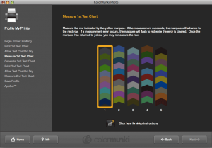

The ColorMunki software generates a test chart with five test strips that you print on the paper you wish to calibrate to. After waiting 10 minutes for the prints to dry, you slide the ColorMunki across each strip. If it fails to scan, the strip is highlighted in red on the screen and you scan again. After you finish the first chart, you print off a second chart with new colors and repeat the process. When you finish, you save the results as an ICC printer profile. Mac users can also use ColorMunki’s AppSet to configure your Adobe and Quark applications to print with this profile. If all goes well, this should take about half an hour.
The yellow highlight shows you which test strip you’re
supposed to scan. It glows red if the scan fails.
