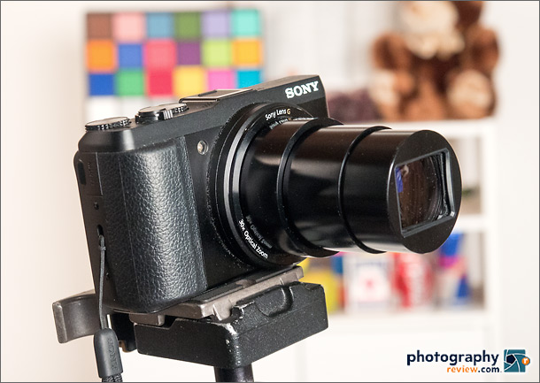

Most of you know by now that my favorite point-and-shoots are pocket superzooms – pocket-sized cameras with 10x or longer zoom lenses. Based on features and specs, the Sony Cybershot HX50V is currently my top pick for a pocket superzoom camera (Pocket Superzoom Camera Guide). A big part of that is the HX50V has the distinction of being the most, ahem, well-endowed pocket superzoom camera this year. It has an amazing 30x optical zoom lens and it really fits in a pocket. (Yes, I am happy to see you.) Spec-wise it’s definitely the best in its class. But how does it compare in the image quality department? Let’s find out.
I’ve taken a careful look and done some close comparing with our Sony Cybershot HX50V studio tests and they are definitely point-and-shoot quality, which is to say – they are on par with other point-and-shoots and pocket superzooms that have 1/2.3-inch CMOS sensors. On paper, the Sony HX50V’s 20-megapixel “Exmor R” CMOS sensor is alluring. However, I don’t think there’s any huge benefit in all those extra pixels. It’s unrealistic to expect a dramatic difference in image quality with the HX50V compared to other comparable cameras. On the other hand, there’s no real downside to the high pixel-count, either. And I do think the extra pixels deliver a bit more detail. There may actually be some benefit at ISO 1600 and 3200 as well, where I think the HX50V is less mushy and retains more detail than other pocket superzoom cameras.
