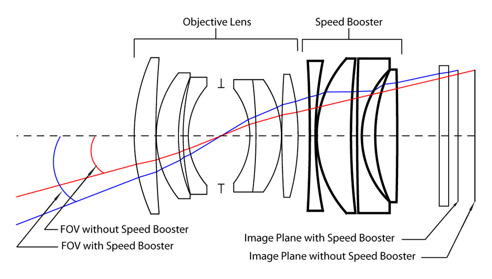

Photo-Dad got right back to me and in his usual physics professor fashion broke the increased aperture claim down so it was easy for me to understand. So what’s the bottom line? The Metabones Speed Booster is legit. Of course, it is impossible for the Speed Booster to add light. That’s why their claim of adding a stop didn’t make sense to me. However, it is possible to add a stop without actually adding light and no black magic is required. Rather than try to explain it myself, I’ll let Photo-Dad do it:
“When the speed booster lens is inserted between the objective and the image, the final image moves toward the objective and is smaller. This means that the ray bundle emerging from the objective is concentrated into a shorter distance after the speed booster so that the combined focal length is smaller and the final image is smaller. Since the ens diameter doesn’t change, the f-number increases. You don’t actually get more light onto the focal plane, but the same light is now more concentrated (smaller image), hence brighter. So the lens booster makes the objective behave in every way like a wider angle lens with larger f number.”
If you got a little dizzy reading that, the critical bit is near the end: “You don’t actually get more light onto the focal plane, but the same light is now more concentrated (smaller image), hence brighter.” So I was correct, it’s impossible for the Speed Booster to add light. However, it’s able to increase the maximum aperture by concentrating the light. I saw someone else describe this as a reverse tele-converter. That’s a good description since the Speed Booster converter decreases your lens’s focal length, making it wider. That’s the exact opposite of a tele-converter, which increases your focal length and decreases your maximum aperture.

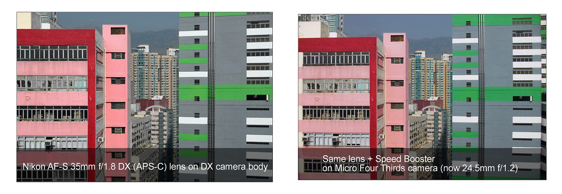

Based on reports from early adopters and Photo-Dad’s technical evaluation, I think the Metabones Speed Booster looks pretty sweet – if you want to use larger SLR lenses on your mirrorless camera. On the other hand, for me, the whole point of mirrorless cameras is the small package. And using SLR lenses pretty much voids that benefit. But the Speed Booster does offer increased versatility for photographers using mirrorless system cameras. Click on the images below to see what the Metabones Speed Booster can do with a Nikon DX lens mounted on a Micro Four Thirds camera.
