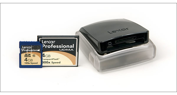

Lexar’s Professional UDMA card reader is a compact, collapsible memory card reader with slots for SecureDigital and CompactFlash memory cards. It has a USB 2.0 interface and can read the new UDMA CompactFlash cards as well as high-capacity SDHC SecureDigital memory cards. I’ve been using the Lexar Professional UDMA reader in the office and on the road for a few months now and recently tested it against a couple of other card readers.

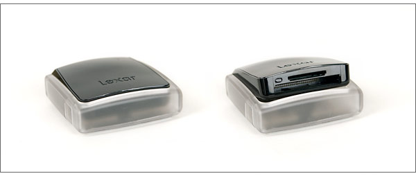

I really like the compact size of the Lexar Professional UDMA card reader and the way it closes up to protect the card slot connections. I’ve had connector pins bend in readers while I’m on the road and that’s very, very bad if you’re working and need to download photos in a hurry. The Lexar reader has buttons on either side. Press both buttons and the spring-loaded reader pops up, revealing the SD and CompactFlash card slots. Although the reader feels sturdy, I had one of the buttons break while it was traveling in my laptop bag. And I even had it in a padded envelope to protect it. It still opens and closes fine but it’s not as pretty as it was when I first got it. Between the button breaking and the glossy finish, I think Lexar should include a small, protective case to ensure the card reader doesn’t get damaged or scratched. Since it is collapsible, it appears designed for travel and a case would make perfect sense. It just seems like an obvious accessory to include with a card reader that’s designed for traveling pros.
Lexar Professional UDMA USB 2.0 Card Reader - Open and closed
