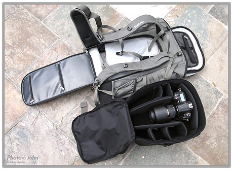

The Tilopa pack is designed around F-Stop’s ICU “Internal Camera Units” (see photos, below). The ICU is a removable, padded, zippered camera compartment – it’s sort of like a strapless pack that goes inside your actual backpack. The purpose of the ICU is to allow you to easily customize your pack for the amount of gear you need to carry. You can easily remove the ICU to store your gear, switch packs or even pack the ICU in a hard travel case. F-Stop makes two ICU sizes and the Tilopa comes with the large ICU (7.5″ Deep x 11″ Wide x 15″ Tall). Camera access is through the back of the pack, behind the shoulder straps. This is especially important for ski photographers because it helps keep ice and snow off your back. But backpackers will also appreciate it because it will keep dirt and mud off the shoulder straps and your back. The main camera access zipper is quick to open and close but the ICU zipper was difficult so I left it open most of the time. That made me worry that the ICU would shift and dump my camera gear out into the main pack compartment. That never did happen, though.
F-Stop Tilopa camera pack with ICU "Internal Camera Unit"
F-Stop Tilopa camera pack rear with camera compartment closed. F-Stop Tilopa camera pack with ICU camera compartment open.

I also had mixed feelings about the ICU. True – it does make the Tilopa more versatile – you can remove it and you’ve got a larger, non-camera pack; or you can use the smaller ICU to make room for more clothes, food or other outdoor gear. The ICU is also good for transporting and storing your gear when it’s not in the pack. However, the ICU adds an extra layer of complication when accessing camera gear. Getting in and out of the pack quickly is often critical for action sports photography and opening and closing the ICU adds an extra step. But the biggest issue, which I mentioned in the “Experience” section of the review – the Tilopa’s internal frame and the ICU don’t play together well. At first I thought maybe the internal frame was bent and getting in the way of the ICU zipper. That’s not the case, though. The frame just plain gets in the way of the zipper and makes if difficult to zip completely. The frame also gets in the way of lenses that are stored on the side of the ICU. I realize that the frame is a critical component of the pack. But if it really gets in the way of using the pack, maybe it should be redesigned.

    On the Internal Camera Unit (ICU) access – we actually designed the pack to be used with the lid of the ICU unzipped when it is in the pack. We only left the lid on the ICU so it could be used as storage when not being used in the pack. So putting the ICU a little behind the opening on each side helps to keep your gear secure when you have the panel open. Most of our photographers are definitely run and gun, and I think our system actually provides one of the fastest and easiest ways to get to your kit while keeping gear safe.

    As for the frame getting in the way as mentioned in this review, I also ran into that problem when first using the pack. I did learn after the first couple days there is no need to zip the icu when it is in the pack. Also, I got used to pulling the frame out of the way and or shifting the icu inside the pack (only talking an inch or so) and haven’t thought twice about it since my first week with the pack.

    On the ICU issue i can see that maybe a issue on zipping it up but really I found no need anyway since everything is very secure without it zipped up. To me I would rather tuck that cover away anyway. Horse for courses of course

    I’ll add my $.02 on the ICU and frame as well. As mentioned by the f-stop guys above, you’re not meant to zip the ICU shut with it’s flap while it’s in the bag. I just flip my flap under the ICU (or is it over?) when in place and have no issues. The ICU is designed to be removable for at least 2 reasons I can see. The first is so you can use the pack w/o it, or use the ICU to just store camera gear outside of the pack. Nice, but not anything I’d do. The second is so they can offer different sized ICUs… This is BRILLIANT. I have the large, but I’m also looking at the small (not available yet I don’t think) for those days when I want my body and 2~3 lenses and more non photo gear… This gives me a lot more options with this bag as the Large DOES take a lot of the usable space. I’m looking forward to the loka (a smaller version) that’s coming out soon and I’ll get it with the small ICU to give me 4 size combinations…
