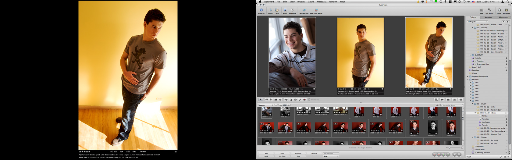

New vignetter/de-vignette tools as well as a vibrancy adjustment are amongst many tools allowing more creative options without needing to move to an external editor and prevent wasting HD space on a duplicate file. Right image is the master file, left image is the adjusted version.

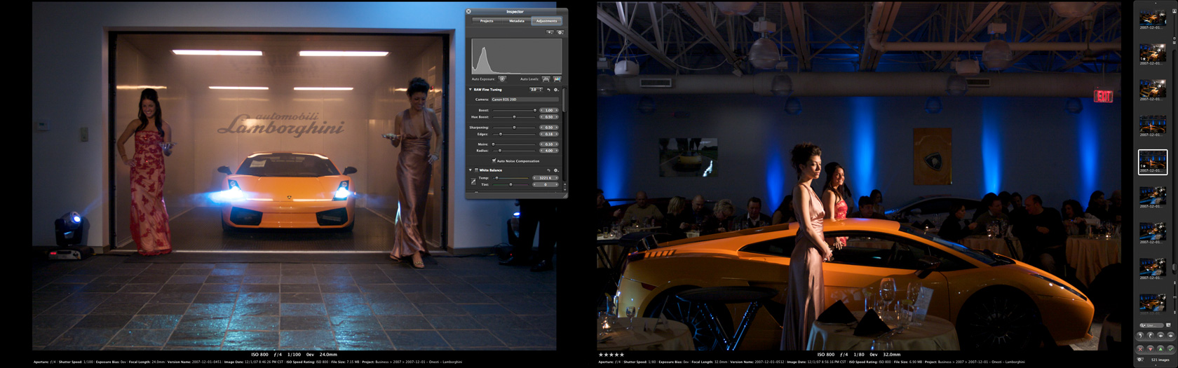

Aperture 2.0 full-screen mode across 2 monitors. Notice the new tabbed inspector providing the ability to switch projects and adjust metadata without switching display modes.

The new inspector (right side of right screen) sits on one side of the screen, negating the need for two open panes, and can be hidden entirely.

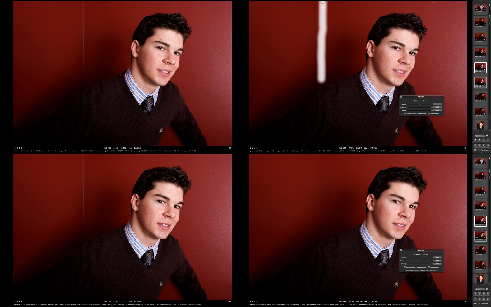

Left side is the master image, right side is the modified image. Top shows the stroke being applied, bottom shows result. No new files, totally non-destructive.
Adjustments stay largely the same, but the few new additions are very welcome. Vibrancy and localized contrast (AP2 calls it “definition”) replace what used to take many steps using other tools. Vignette/de-vignette tools allow for finely controlled creative effects or make up for shortcomings of lens designs. The two headliners in this category are the Retouch Brush and the plug-in API. AP2′s Retouch Brush is essentially a non-destructive version of Photoshop’s healing brush. Strokes are stored in the database and can be deleted at any point. I wish one could choose a stroke to eliminate, since now I can only go back step by step linearly. Being able to jump in and delete just stroke 2 out of 3 would be a great workflow enhancement. The plug-in API has huge implications. Nothing has officially been said yet, but it’s obvious that image manipulation can now be handled by plug-ins. Noise Ninja inside Aperture? YES PLEASE.

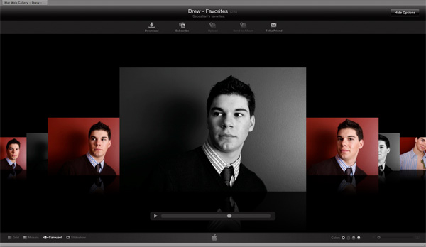

Support for .Mac galleries bring password protection, impressive presentation and ability for others to upload and share files.
One of Aperture’s greatest strengths has always been its excellent book designer. In 2.0 Apple improved it by allowing you to create custom sized books, which when exported as PDFs, can be sent to any supporting print house. I have used Sharedink.com for books designed with Aperture and the results have been excellent.
On the web front, Aperture finally supports the excellent web galleries introduced with iLife 08. The downside is that they require a .Mac account, primarily because of their interactive nature. Access to the galleries is entirely controlled by the photographer. Password protection can keep the images private and options include the ability to allow downloads of individual images (including RAW), the ability for others to upload images to the gallery and the ability to email images to be added. Each option can be toggled on and off, even after publication. Any images others upload are synced back into your library, making sharing between friends and family seamless. As a bonus, these galleries detect when an iPhone or iPod Touch is used for browsing and reformat the interface for the smaller displays.

    I would like to know which adjustments were made on the first picture of this article (http://www.photographyreview.com/reviews/files/2008/02/ap2-vignette.jpg). I don’t use to change my photos but I realized there’s a way to make the picture better… more colerfull and I don’t want to use Photoshop, just a simple way to do that.
  • Thiago,
    The only changes made were a contrast increase (higher contrast increases saturation a little) and the addition of vignette.
    Hope that helps.
    -Seb
